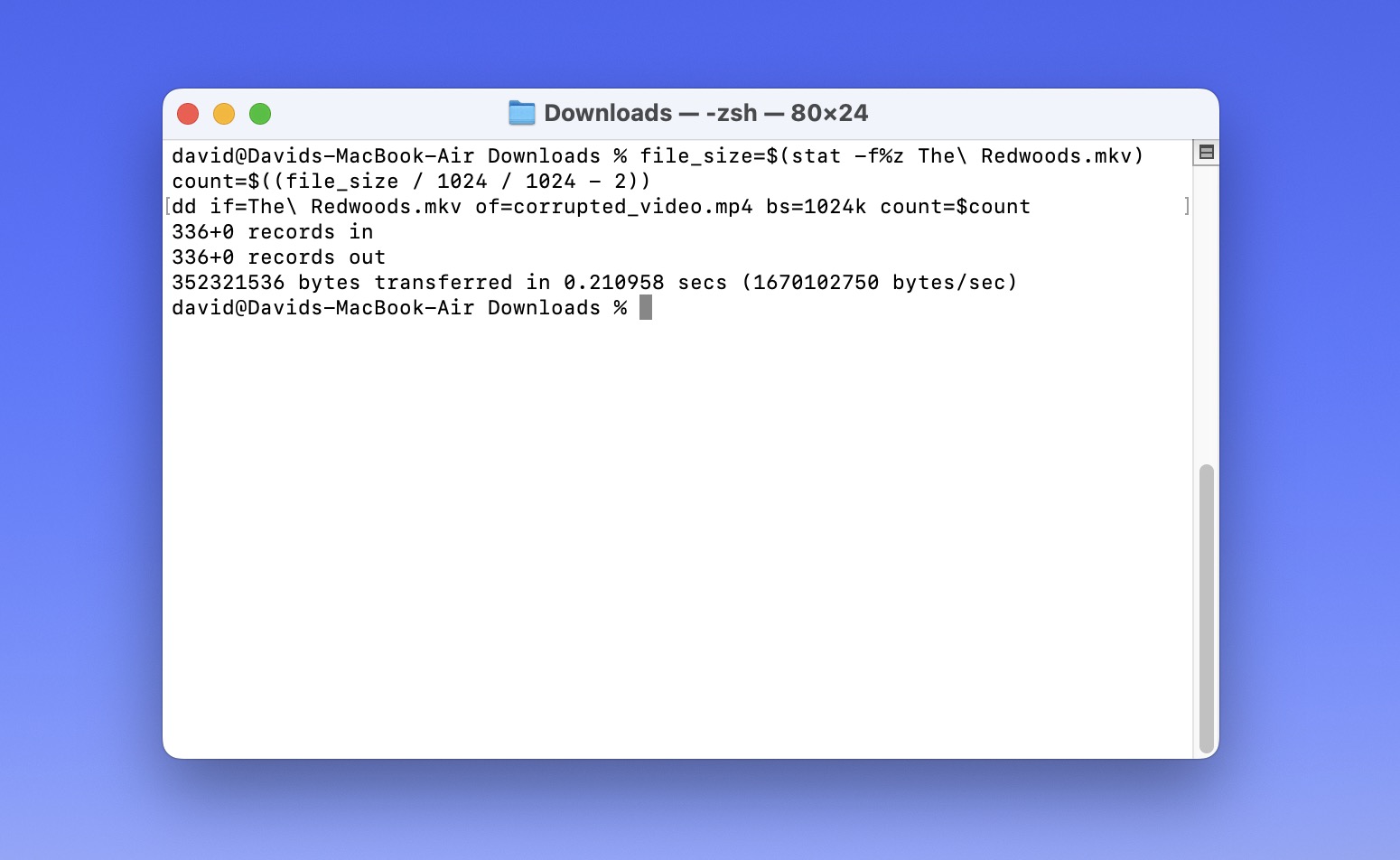

corrupted video creation
I created these test files by taking a working video file and cutting off the last 2 MB using the following command:
file_size=$(stat -f%z input_video.mp4)
count=$((file_size / 1024 / 1024 - 2))
dd if=input_video.mp4 of=corrupted_video.mp4 bs=1024k count=$count
This command uses the dd utility, which is available on macOS, to calculate the number of blocks to copy while subtracting the last 2 MB.
The purpose behind this second test was to verify that the tool could reliably fix files interrupted during recording, mimicking real-world scenarios like my daughter’s birthday video.

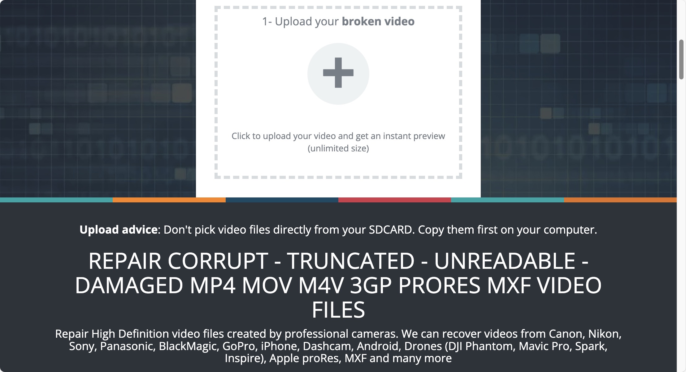

2. Fix.video
fix video
Supported file formats: P4, MOV, M4V, 3GP, ProRes, RSV, MXF, and more
Fix.video can fix a large number of video file formats without imposing any upload size limits. Yep, you can upload files of any size, which is a huge advantage when dealing with high-quality or long-duration videos.
In my tests, Fix.video successfully repaired both MP4 and MOV video files, and the repair process was impressively fast. Only my test MKV file failed to be repaired because the file format isn’t supported by the tool. While Fix.video showed me all the files I had uploaded in the last 12 hours, it doesn’t have a comprehensive user dashboard similar to the one found in Clever Online Video Repair, which includes complete repair history and the ability to manually remove repairs.
What I didn’t appreciate at all was the fact that Fix.video lured me with a low-quality online preview of the repaired video. Excited to see my damaged video repaired and ready for download, I clicked the “Download the recovered result” button and was saddened to see a familiar PayPal purchase window appear, asking me for $6.00 to download a full version of the video. Indeed, Fix.video isn’t as free as it makes you believe, unless you can be satisfied with the free low-res preview, which I assume some people might be.

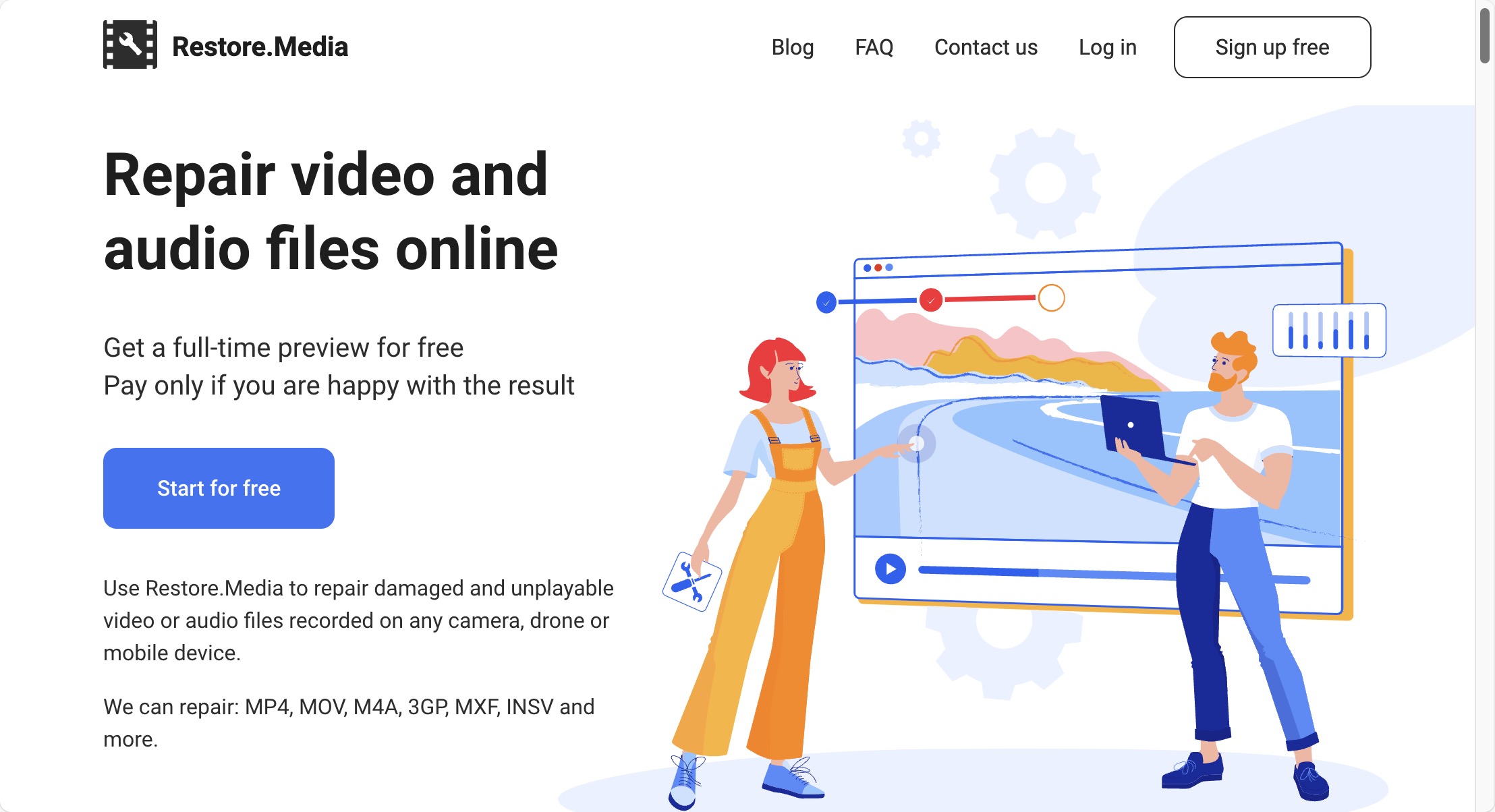

3. Restore.Media
restore media
Supported file formats: MP4, MOV, M4V, M4A, MXF, 3GP, INSV, and RSV
Restore.Media employs the most sophisticated, but also the most complicated, repair process among the free online video repair tools I tested: it uses a reference video file to determine the optimal repair process. This can lead to impressive results for severely corrupted videos, but don’t expect the process to be quick, especially because you need to create a user account before you can even begin it.
In my tests, Restore.Media managed to repair all my test files except for the MKV, as this video file format isn’t supported by the tool – a common theme among video repair tools. However, Restore.Media is limited in the same way Fix.video is: only a low-resolution preview is free.
The tool charges from $4.99 to download a high-resolution repaired video file (so slightly less than Fix.video), and the price is once again determined automatically based on the size of the damaged video by the professional video repair tool itself. Going through all the trouble of creating a user account and providing a sample file just to greet you with a paywall can be a real bummer. Still, a free low-res version of an important video is still better than no video at all.

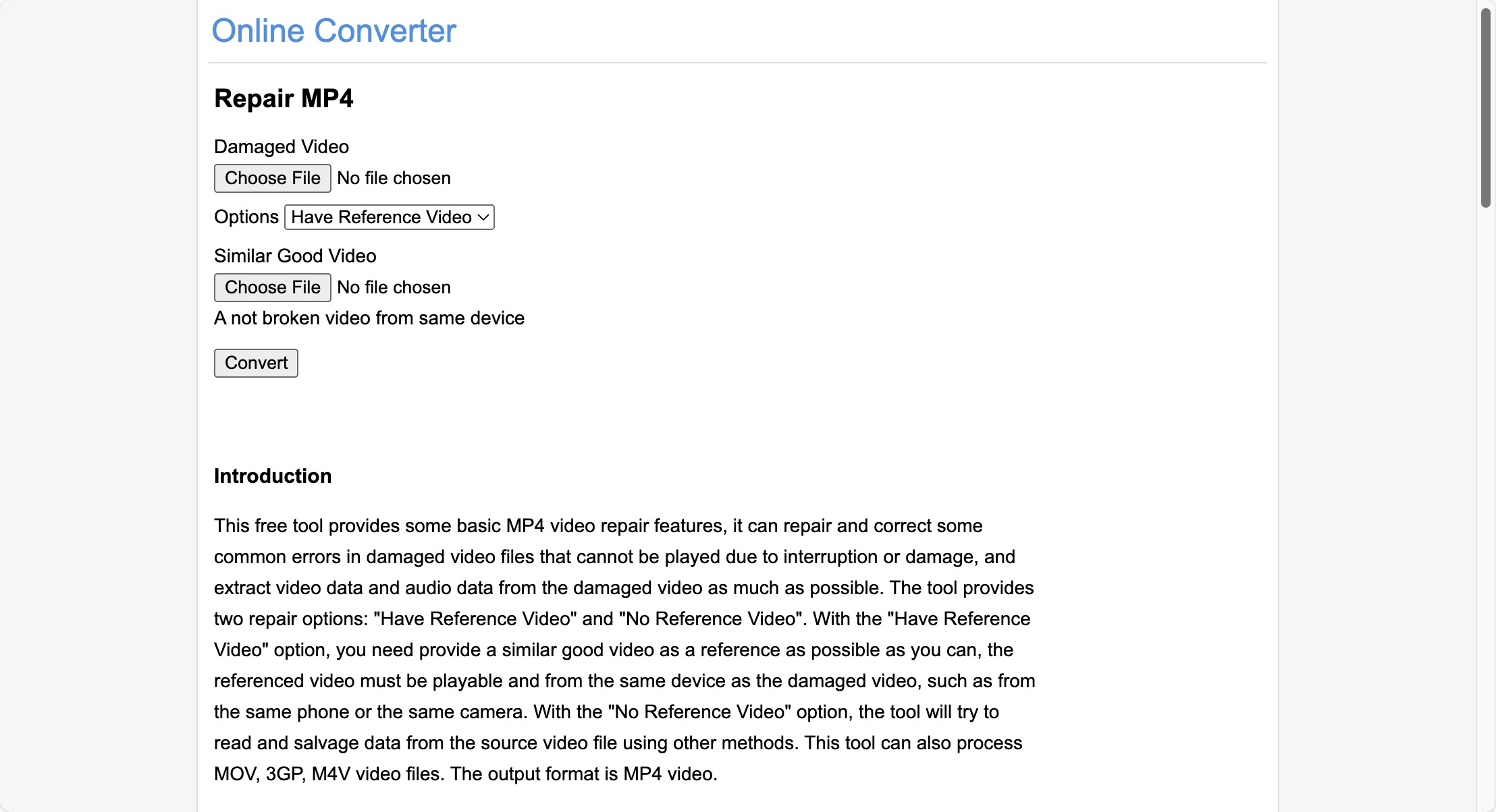

4. Online Converter MP4 Repair
online converter
Supported file formats: Only the MP4 container with various file extensions is supported
Online Converter MP4 Repair is a straightforward video repair tool that, just like Restore.Media, can use a reference video to aid in the repair process, but you can also attempt to repair your video without providing any reference material. Regardless of how you choose to repair your video, you will never be asked to pay any money (I’m still bitter that Fix.video and Repair.Media asked me to pay $6.00 and $4.99, respectively, to download a high-quality video file).
You can jump right in and start repairing your videos without any sign-up process. First, you upload your damaged video, then you choose between “Have Reference Video” or “No Reference Video” options, and, finally, you click “Convert” and wait. I’ve verified the tool’s ability to repair various forms of the MP4 container, which is all it claims to be able to do.
The biggest downside is that Online Converter MP4 Repair has a strict 200 MB file size limit. In today’s world of high-resolution videos, this can be quite restrictive. For context, just a few minutes of 4K video can easily exceed this limit.

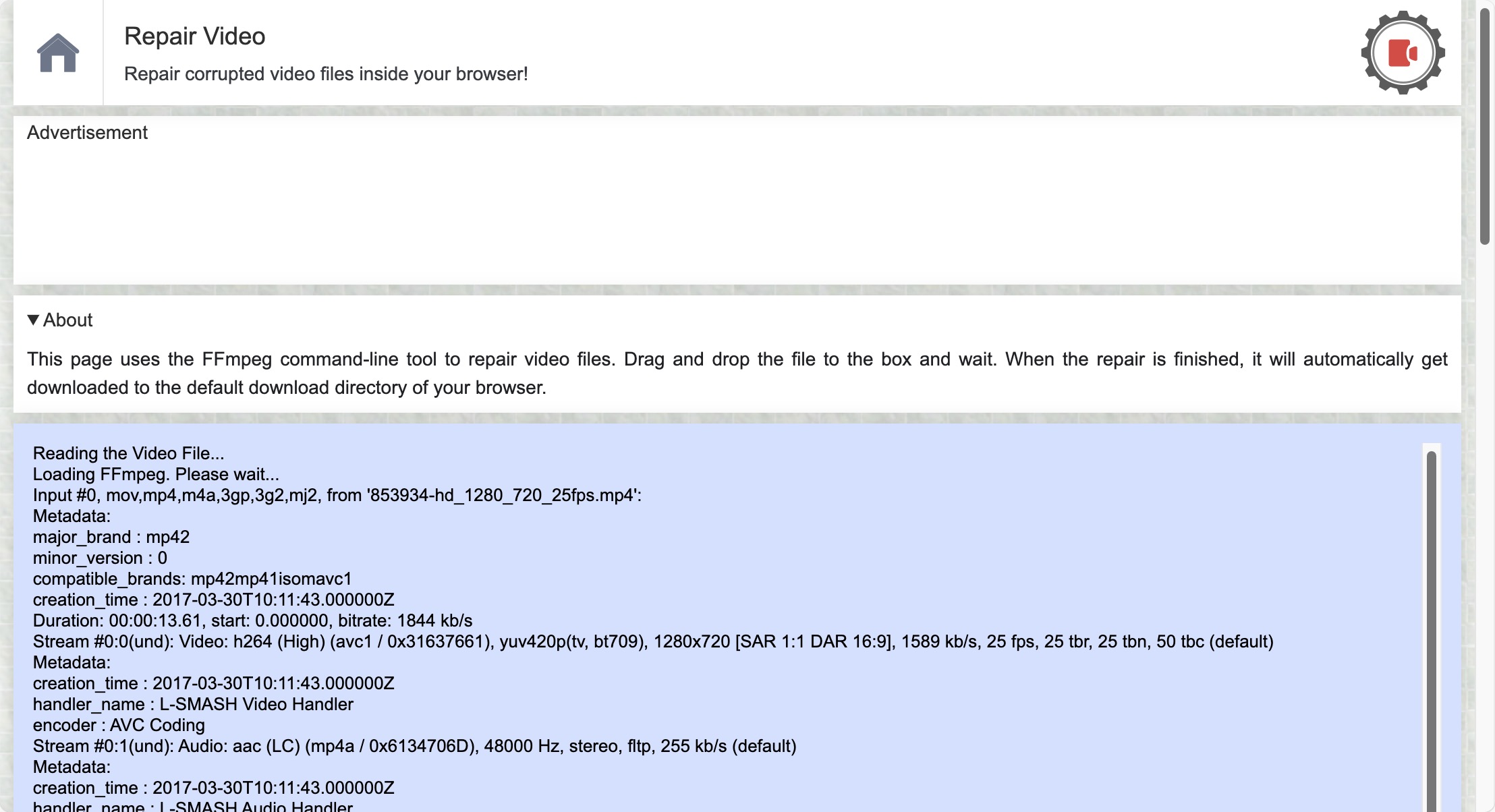

5. WebBrowserTools Repair Video
repair video
Supported file formats: All video file formats supported by FFmpeg
WebBrowserTools Repair Video is a unique entry in this list of free online video repair tools because it uses FFmpeg, a powerful open-source software suite for handling multimedia data. For those unfamiliar with FFmpeg, it’s a command-line tool widely used by professionals for processing video and audio files.
The use of FFmpeg means this tool supports an impressive array of video formats – basically, if FFmpeg can handle it, WebBrowserTools Repair Video can attempt to repair it. This broad support is how it managed to be the only tool in my test suite capable of repairing my corrupted MKV file. Interestingly, it failed to repair my MP4 file, and I’m not sure why.
Because WebBrowserTools Repair Video is an online video file repair software tool, it makes FFmpeg far more accessible than it typically is. Instead of wrestling with command-line interfaces (which can be intimidating for non-tech-savvy users), you can simply drag and drop your file onto the webpage. File size limits aren’t mentioned because the processing happens on your own machine, so they depend on your browser’s capabilities.
